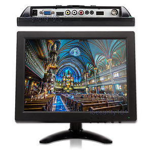

Mini SVGA/HDMI Monitor
If you like to experiment a lot, consider investing in a small LCD monitor (with SVGA and HDMI input), like the one shown below:
These monitors are compact and can be tucked away when not in use. (Above picture is provided as illustration only, it’s not a recommendation).

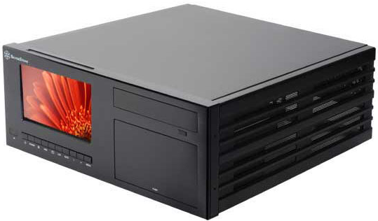

Another approach is to spend the money and get a case with a built in monitor. The downside of a LCD case is the bulkiness, and the connection is not always internal (e.g. if your motherboard don’t have a internal HDMI/VGA header you have to route the connection out externally). Given the price, this is not a practical solution, but it looks cool! Some motherboards support LVDS monitors but I havn’t tried them yet.

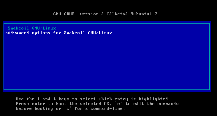

Connect the monitor and keyboard, boot up the computer and hit any arrow key immediately until you see this screen. You only have a short window to do this, reboot the machine again if you are not quick enough.

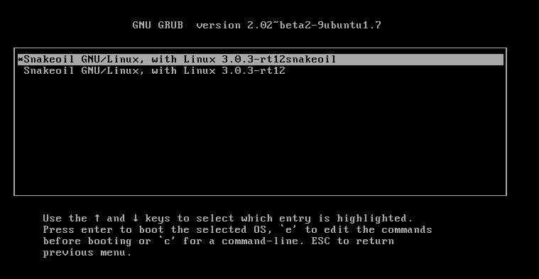

Once you see the screen above, make sure the entry “Advanced options for Snakeoil GNU/Linux” is selected (see example below), and hit the “Enter” key. You should see something like this. Select the first line from the list (Linux 3.0.3-rt12snakeoil in the example) and press the “Enter” key.
The machine should boot up fine now. Return to the Snakeoil menu, and select another working kernel.
