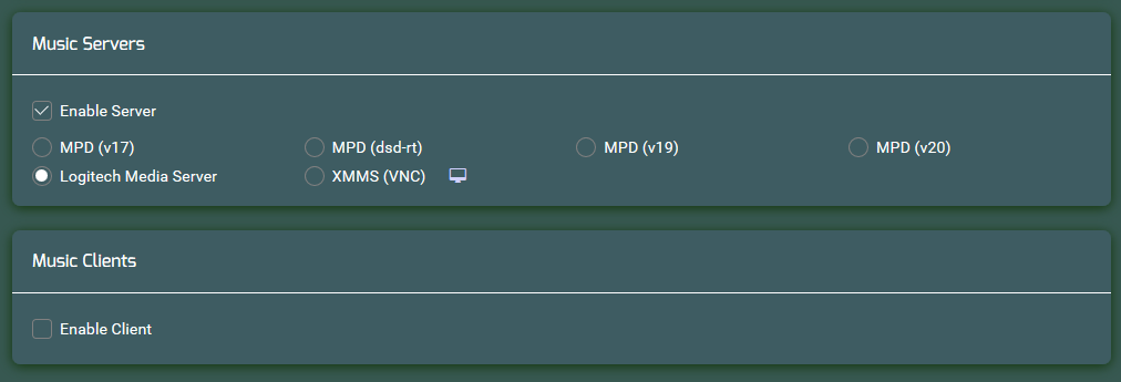

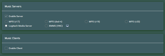

The following picture is the player setting you should set for your Server machine. This is the machine where you run Logitech Media Server. This is also the machine where all your music files are store. This machine will stream music to all your clients.

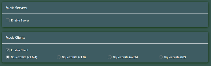

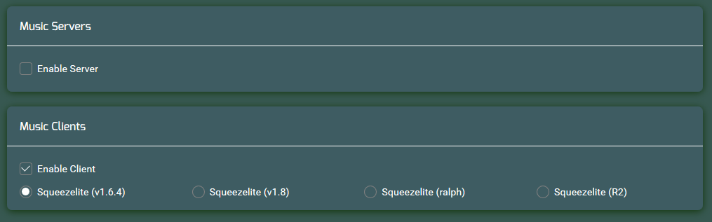

The following is the player setting for your client machine(s).
