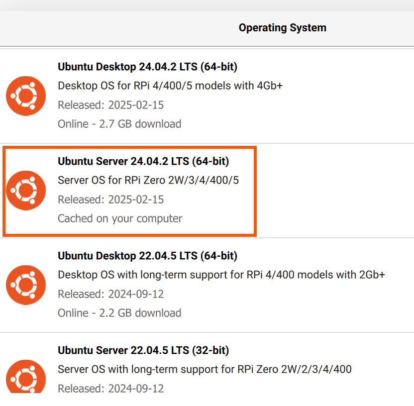

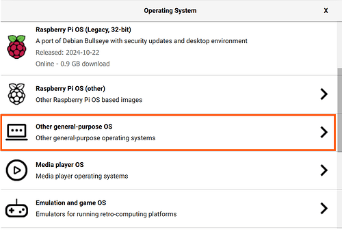

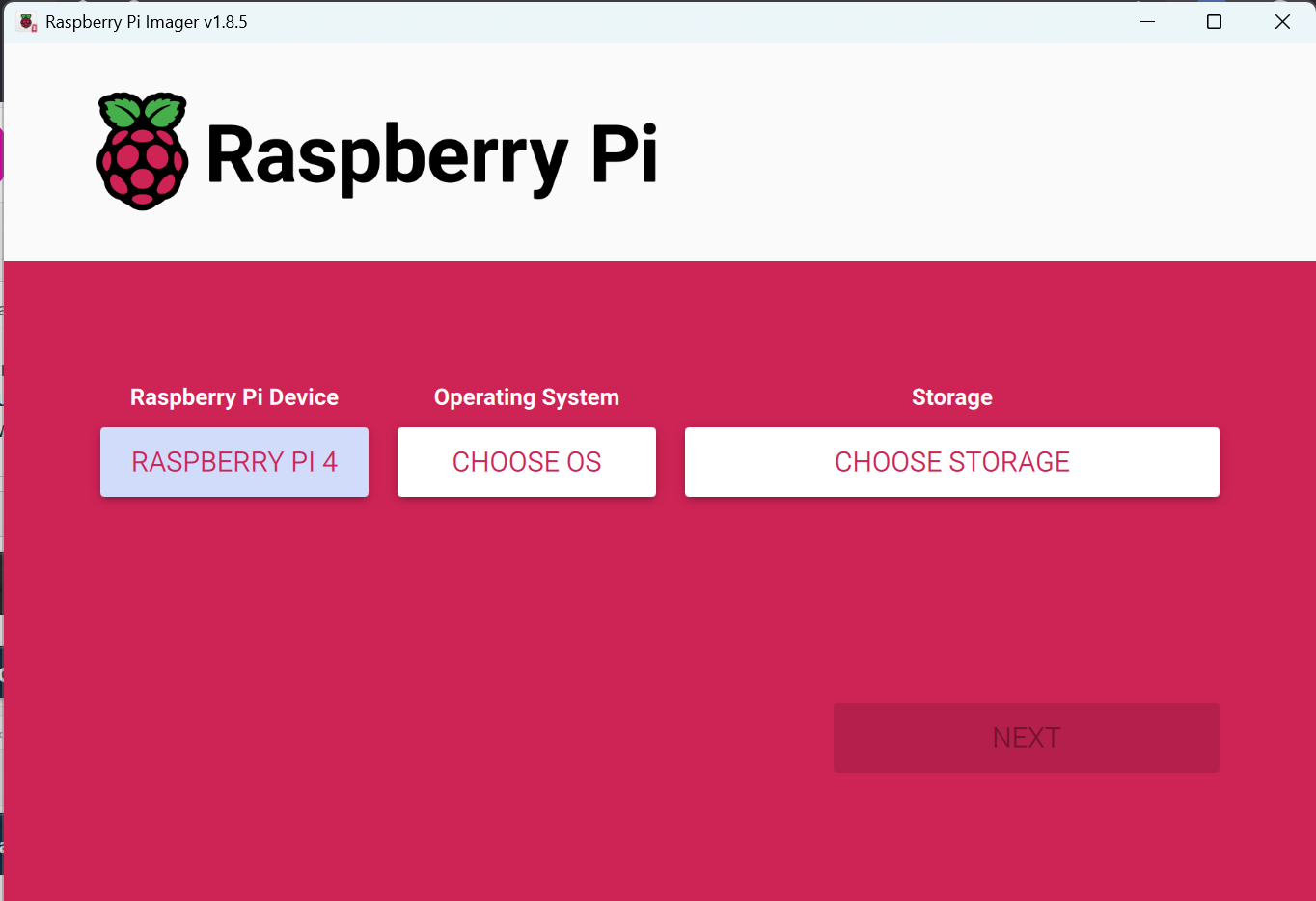

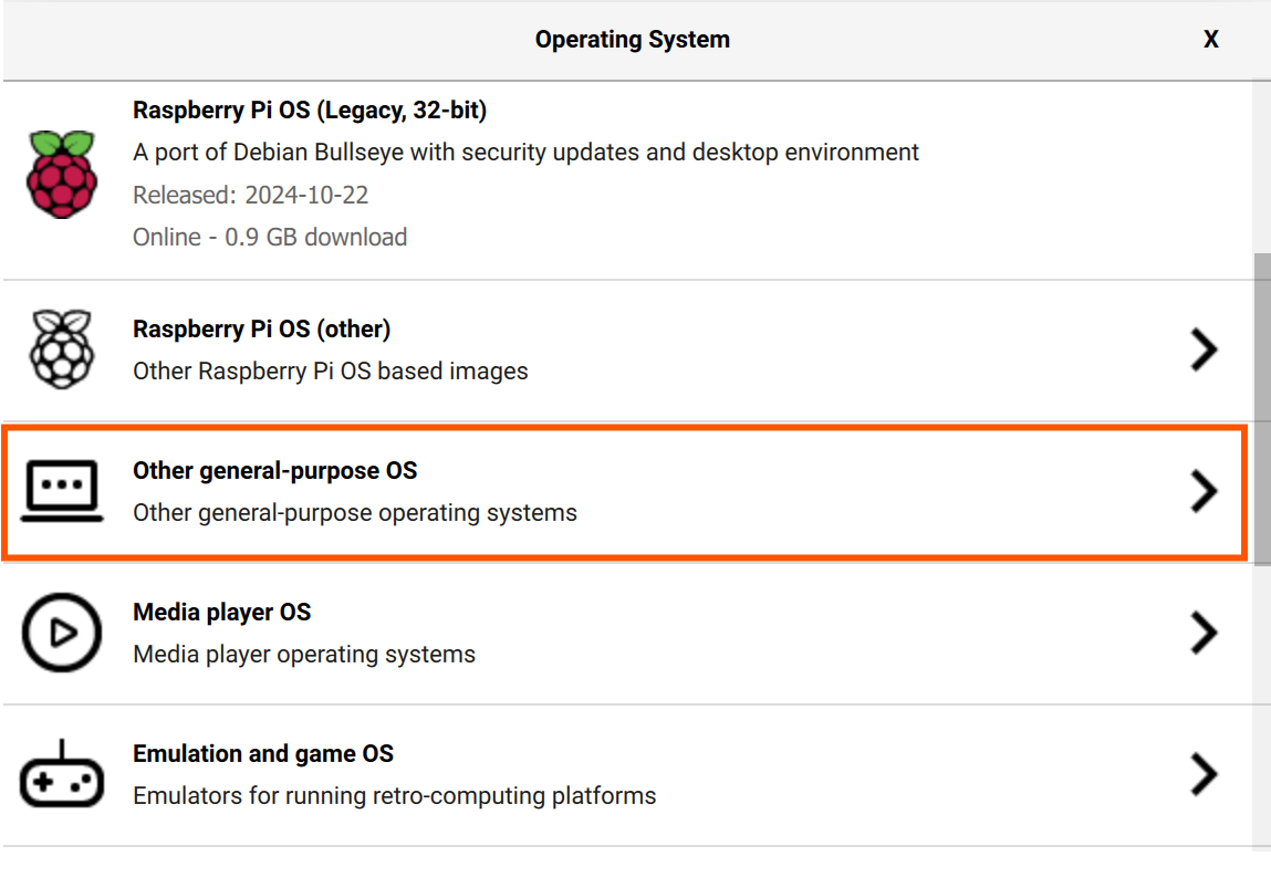

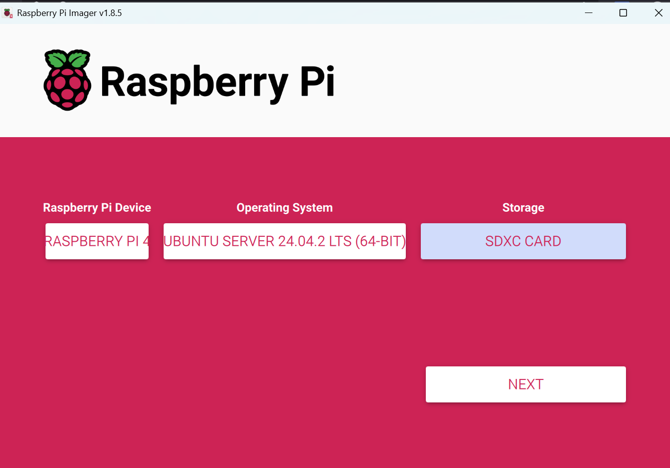

Download the Raspeberry Pi Installer here and use it to install Ubuntu on a micro SD card.

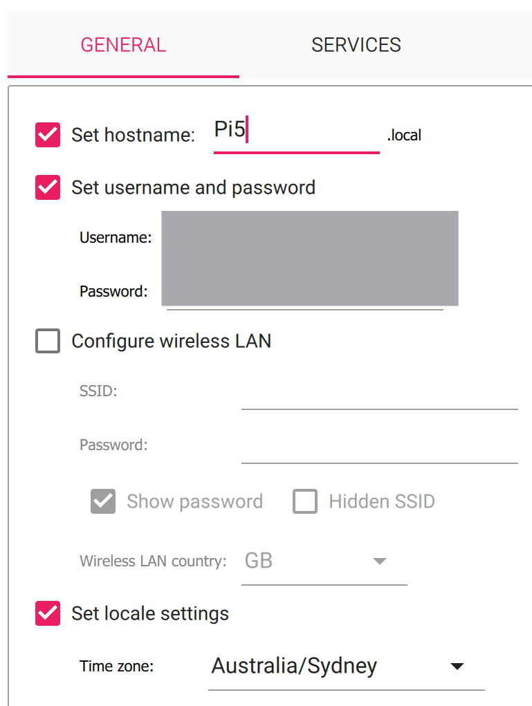

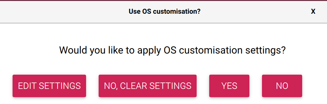

Edit settings (if required).

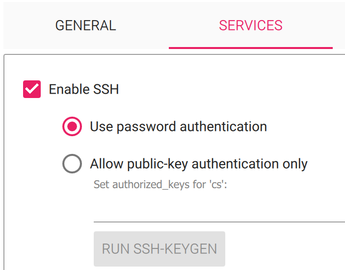

Please ensure that you have enabled SSH. Do NOT configure wireless LAN. Snakeoil is designed for a wired network and will fail if wireless LAN is enabled.
Please note that SnakeOil does NOT work with Raspberry Pi OS.
